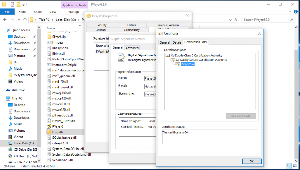

Solution using Windows Update
The easiest way to fix this issue is to update your operating system using "Windows Update" and to make sure that you have the latest Service Pack installed. This operation will automatically install the latest certificates that are required to run PVsyst.
If you still have troubles then you should check the certificate properties of PVsyst application (file PVsyst6.exe located by default in C:\program files (x86)\PVsyst6.X.X\). The content should be similar to the screen capture attached:
In case of error, you can use the button that appears in this dialog to manually install the missing certificates.
