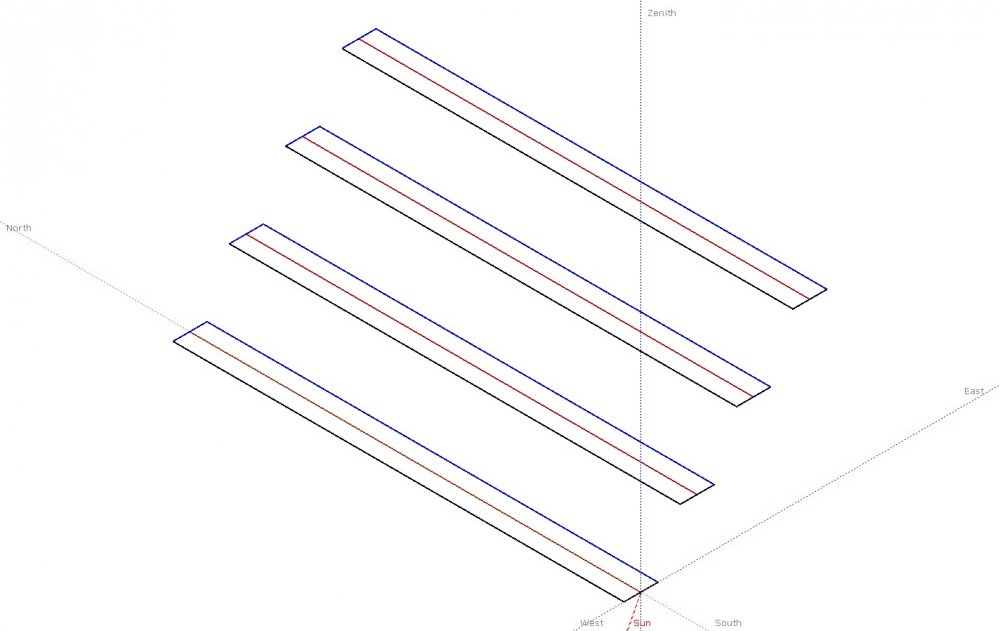

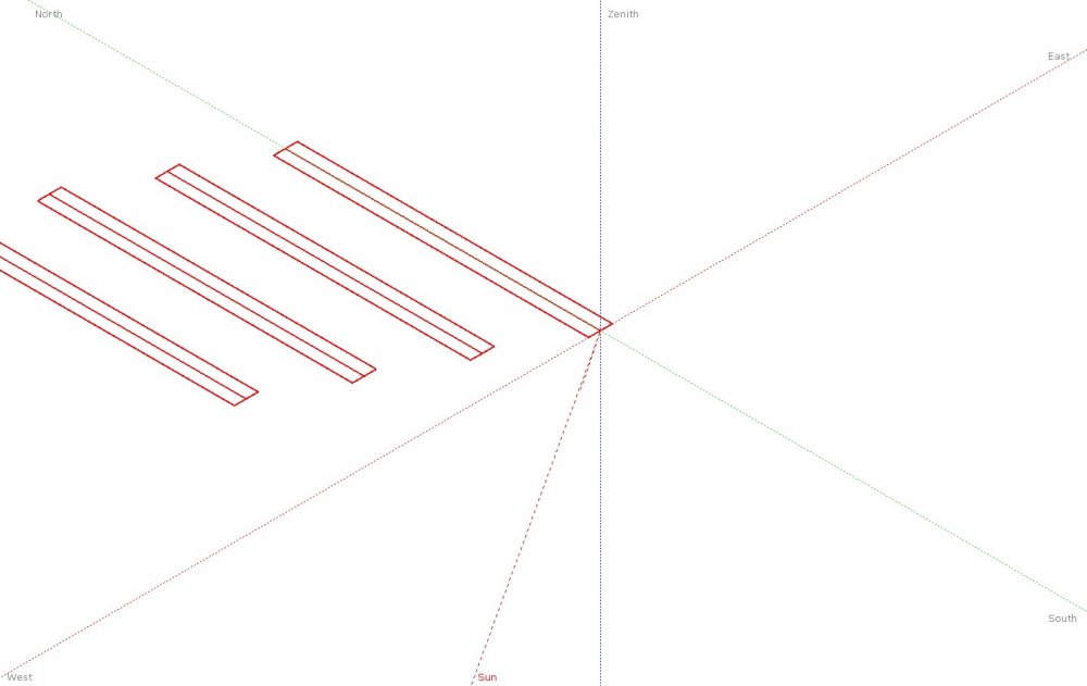

samastor Posted March 22, 2018 Posted March 22, 2018 Good eveningOf course i am dealing with the same problem, since misalignment can only be possible for tracking planes towards the West. I attach two shading scene examples. The East scene can be computed correctly. On the contrary the graphical result for the West scene can only be obtain using the negative pitch value thus computing is not available. Is there any solution to this with the current version? If not with the current version is it expected to be solved with the next one?
unilhexio Posted March 23, 2018 Posted March 23, 2018 Would be wondouful if someone from PVsyst does any comment about this...
