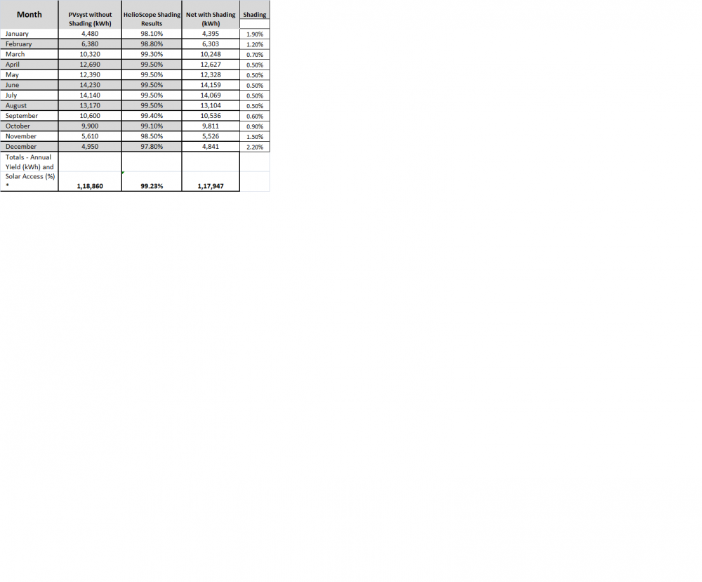

Hi,
I would like to feed the following monthly shading loss % in PVsyst, could anyone give me a solution to do this.
Month PVsyst without Shading (kWh) HelioScope Shading Results (kWh) Net with Shading (kwh) Shading Loss %
January 3,900 93.10% 3,631 6.90%
February 5,550 96.40% 5,350 3.60%
March 8,970 97.50% 8,746 2.50%
April 11,050 97.80% 10,807 2.20%
May 10,780 98.10% 10,575 1.90%
June 12,370 98.20% 12,147 1.80%
July 12,290 98.30% 12,081 1.70%
August 11,450 98.10% 11,232 1.90%
September 9,210 97.70% 8,998 2.30%
October 8,610 96.60% 8,317 3.40%
November 4,880 95.10% 4,641 4.90%
December 4,310 91.60% 3,948 8.40%
Thanks,
Arasan
Shading Loss % Monthwise
In PVsyst, the shading losses are the result of a detailed calculation, involving your system configuration and the irradiance distribution.
You cannot explicitly specify monthly values of course.
