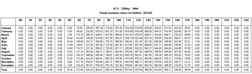

So I got that Pmax(50oC) is the combination of Maximum Global Incident Irradiation (in clear day model) and temperature coefficient?
Then my concern is how can we got the Maximum GlobInc (in clear day model) from Maximum GlobInc value, is there any relation with Clearness index Kt or Best clear day Ktcs?
