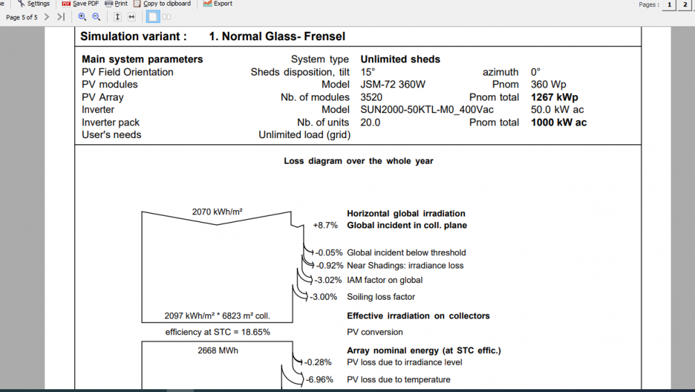

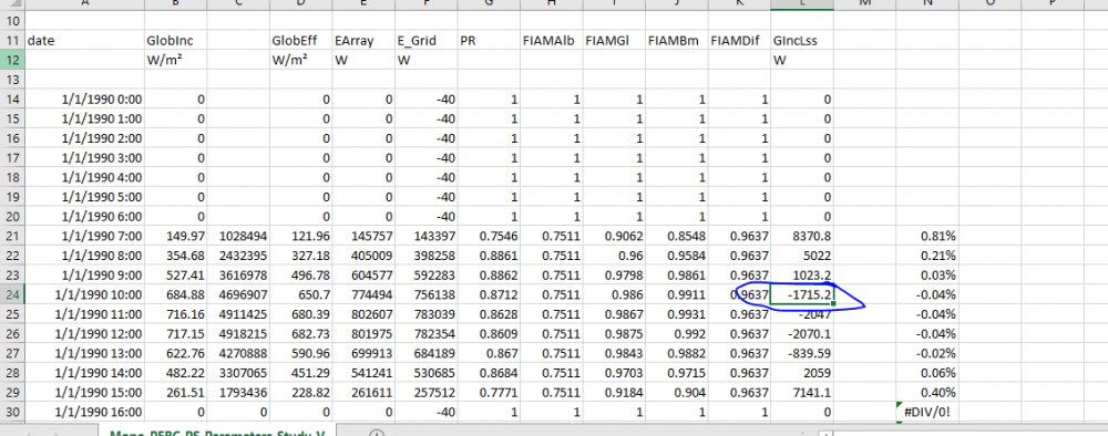

  4. Hello, I checked the hourly data results, and there are negative values for IAM loss (gain), how is that possible?
  5. Hello, Is it okay to have difference between the Detailed IAM study and the results in the loss Diagram?
