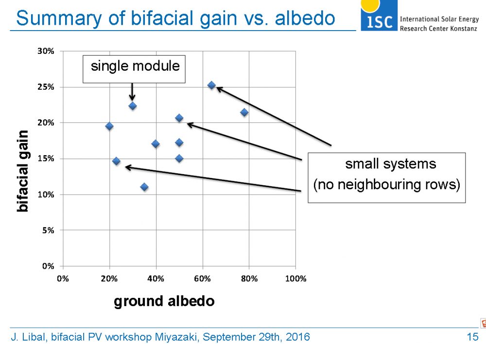

  7. Hi Andre, I also met the same problem with Sebastian, the simulated bifacial gain was significant lower than some actual test results. for example, bificality=0.9, albedo=0.7 distance from ground to module=1m, finally got the bifacial gain =11.4%. compared to the acutal test results, including utility scal system. please see http://hokkaidopvgs.jp/wp-content/uploads/2017/01/41c7223bd0545a0f4dbe8fbccbc00572.pdf , 1.25MW capacity system in japan, bifacial gain about 20%. some other test results are shown a big bifacial gain in actual test. ISC also summaried some test results, at least more than 10% bifacial gian. measured results summary I think the bifaical model should be improved a little, to make it more aline with the actual result . Thanks, Baohua
