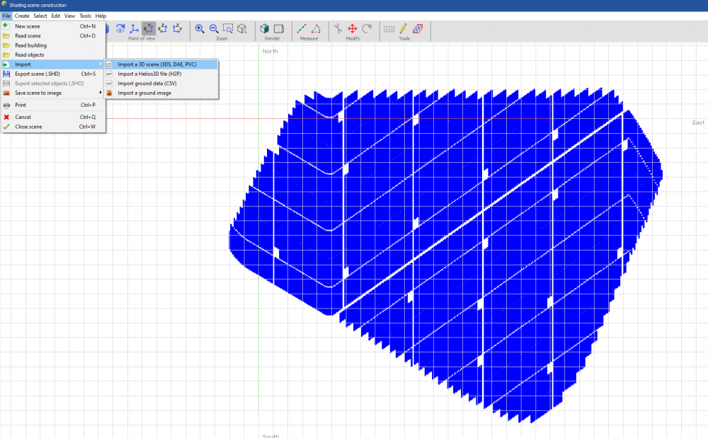

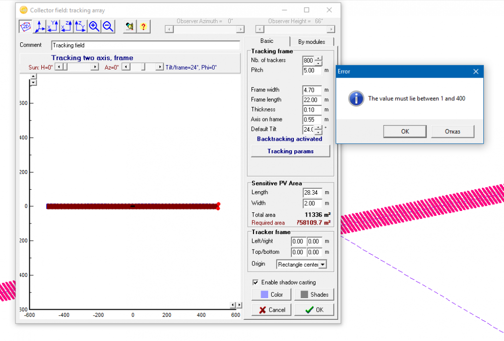

  6. Hi all, I want to calculate shading scene for a big PV Plant with tracking systems (1 axis E-W). I have the following problems: 1. The number of trackers is limited to 200, although PVsyst error message says that it should be 400. Anyway, in my case it have to be 3200! Is this possible and how (if it is)? 2. If I choose to use "partial electrical calculation", how can I do that? There is no such option in the "tools" menu! The "Help" file shows that it should be, but I can't find anywhere! Could you please help me? Thank you in advance! Screenshot02 Screenshot01
