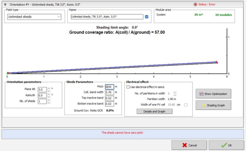

  1. How about this scenario; consider my shed as very long shed and ignoring the reflection from tow side of the table 3,4. see attached image. and regarding the pitch I use respectfully high value ( let say 10m ), so system read maximum value of irradiance reflection from both sides 1 and 2 towards panels backside. Would this works? so I could simply use Unlimited Sheds field type and avoid making 3D and no need for reset error message. What do you think?
  2. Thanks Linda for your prompt response, Appreciate that you've clarified it is not possible to simulate a bifacial system with a single row at present ) : I will go with that possible workaround you've kindly suggested. Thanks a lot and best regards
  3. Hello, I'm working on ONE table on top of carport Bifacial panels together with no distance in between therefore I consider as ONE shed what could be the right pitch value here?. it's one table! I tried zero but system gives an error and when I try 2.3m as space from one panel end to next one I find system later changes pitch value to 22 or 24 m ! also after running the simulation I find almost no impact of bifacial panels on output kw! although they're 2.5m high from ground with 0.3 albedo Anyone could help and advice what would be the right value for pitch and band width in this case? How to resolve this. Thanks Pls see attached images
