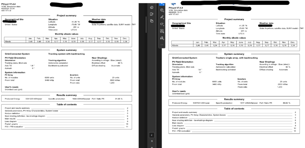

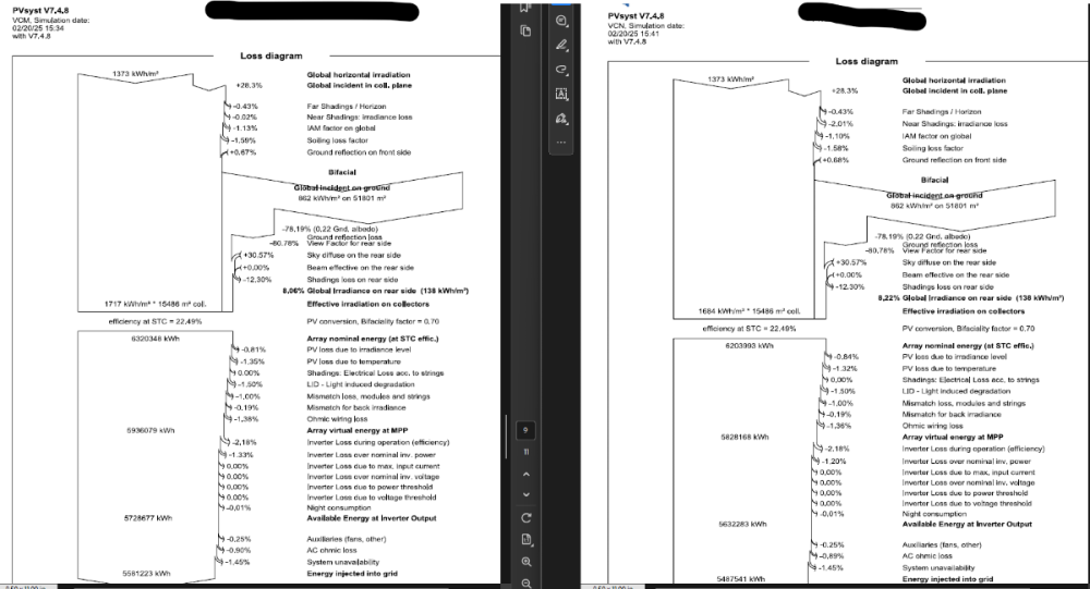

  2. I was running generic simulations and noticed that when I ungrouped the array of trackers I made in the near shade scene the production was higher. The only difference between the two variants below is just whether the created array of trackers was ungrouped or not after creating them in the near shade scene. The grouped trackers has a higher near shadings loss of ~2% for no apparent reason that goes away if you ungroup the array of trackers.
