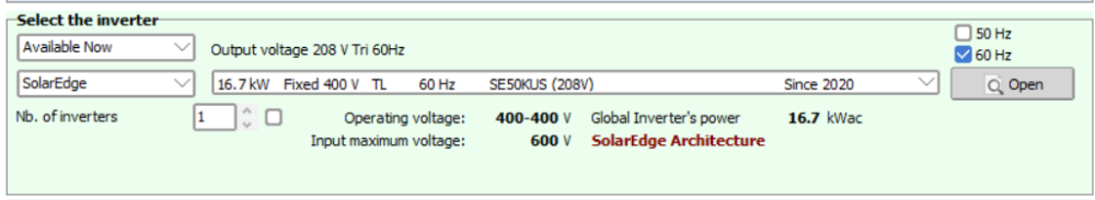

  5. The Solar Edge SE50KUS inverter Three Phase Inverter with Synergy Technology has the output power rating of 50kW, however, in PVsyst its output power rating is indicated as 16.7kW... Could you please look into this?
