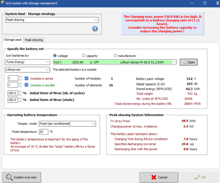

I am trying to simulate a system with a 50 kW inverter and a module of 10 bateries of 512V 103Ah and 51,2 kWh.

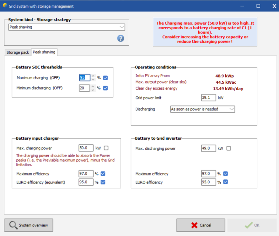

The problem is that when I define the parameters, it appears an error saying the max charging power (50 kW) is too high and I do not understand why.
I attach the parameters I define if anyone could help me it would be great.
