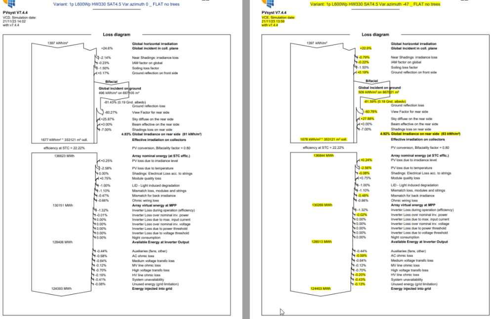

  3. Dear all. Interested in any and all information about modeling of Vertical solar panels, east - west orientation, with bifacial modules. 0.Best frame/ pitch layout 1.How to avoid errors with bicaial (irregular array) 2. How to model into one scene panels facing east and west. (Define facing directions and partitions)

  5. Hello. I have the following staging: same site and two single axis tracker (N-S) variants: - idenatical parameters expet the azimuth.One is 0 degree , one is -47degree. - Backtracking is ON, Latitude 44° 49' 0" N, flat/No terrain Results of simulation indicate better overall performance of the 47degree. Whitch contradicts with articles about performace of deviations from the 0 azimuth. Main difference comes from near shadings. Can someone explain those results? Comparison attached. Sincerely, Vladislav
