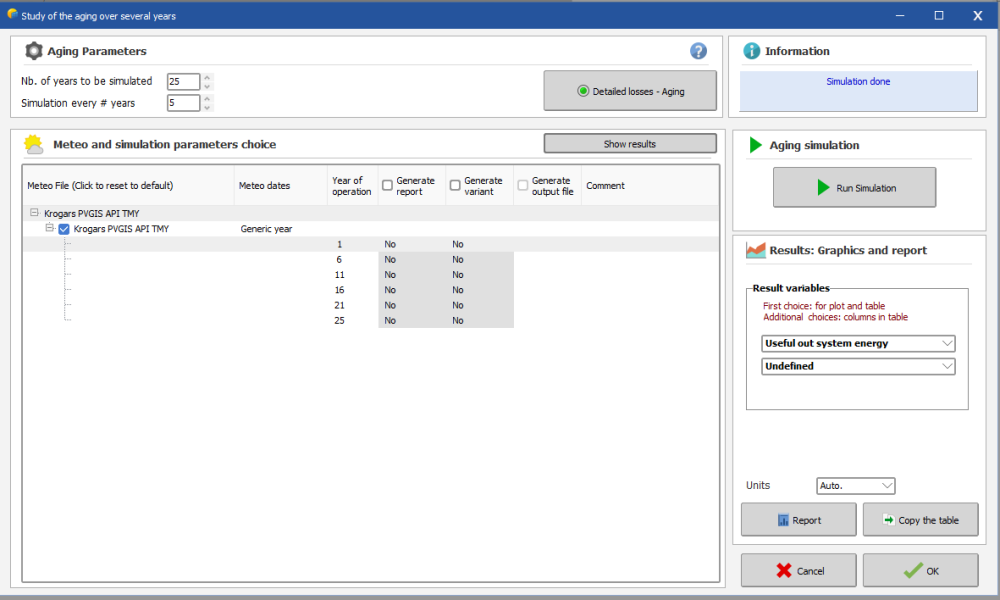

	Hi PVsyst team, The weather file that is used in the simulation of aging tool is generic year. How can I use series of multiple year data for example from 2005 to 2020 instead of generic year for the stimulation?

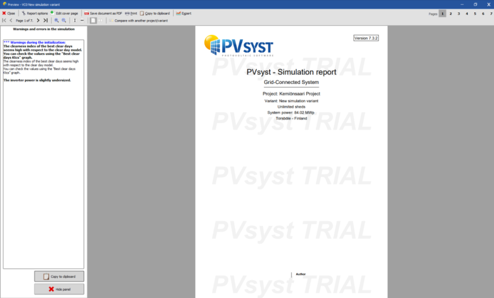

	Hi PVsyst, I made simulation for one Grid-connected PV system that we are planning to install it. In the report there is warning and error message as follow: *** Warnings during the initialization: Initialization;The clearness index of the best clear days seems high with respect to the clear day model. You can check the values using the "Best clear days Ktcs" graph. The clearness index of the best clear days seems high with respect to the clear day model. You can check the values using the "Best clear days Ktcs" graph. Can you give me an brief explanation what does it this message mean? Is related to PVsyst itself or Should I modify something to avoid this message?

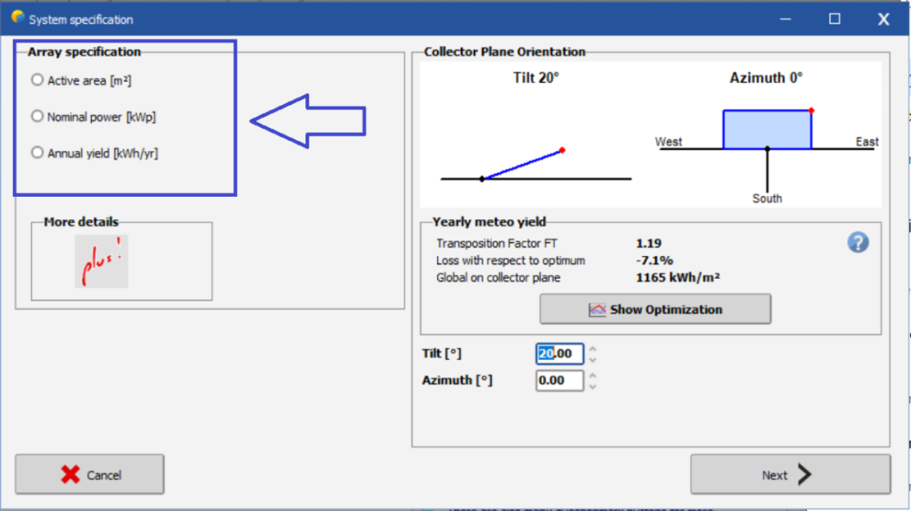

	Hi, We have large-scale solar PV system and the total area of the PV power plant of 95 (hectare). Now we want to make preliminary design for this project just to estimate the the capacity MWp this fits to this area and also we want to estimate the energy yield MWh/year. I started with preliminary design option in PVsyst, but I don't know how can I translate 95 ha to one of these "Array specification" options. As I understood the "active area" option refers to the area of the PV modules not the area of the PV power plant. Please can you give me an idea how can I estimate 95 ha here in the preliminary design?
