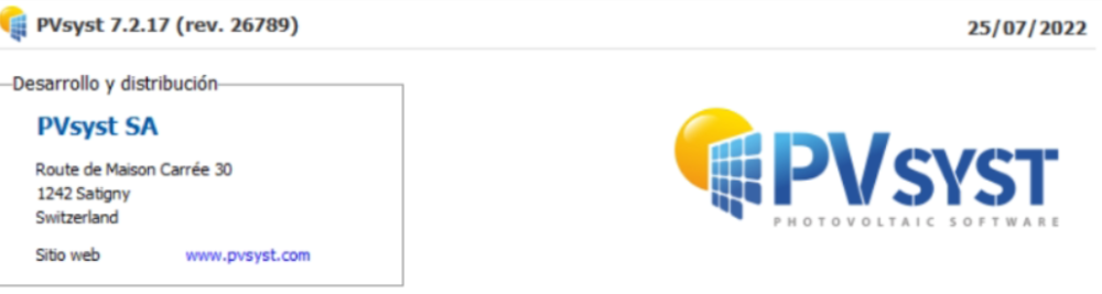

  3. Hi Michele, Thank you for your quick response. The version is 7.2.17 rev.26789

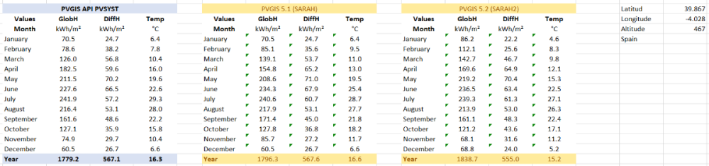

  4. Hello everybody! I would really appreciate some help related to the following issue between the monthly values obtained by API PVGIS TMY (tool in PVSyst) and the data from PVGIS web: I noted that the monthly values obtained by PVGIS API TMY do not correspond to the PVGIS 5.1 or 5.2 version. Why the values are not equal -at least between API and PVGIS 5.1- (in some months is equal or nearly, but, would not it be the same data/results?) PVSyst is using a different/older version of API PVGIS when importing the monthly data? Thank you for your support. Manuel.
