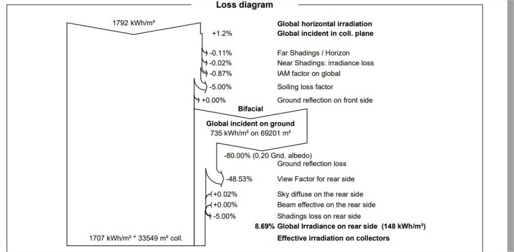

	I think you are doing it right. When you create a .SIT file you are just setting the place downloading just monthly meteo data, see image 1. So you get GHI, DHI, Tamb, Wind velocity and RHumidity.
	So PVsyst generates a synthetic meteo file hour by hour in order to calculate the simulation. See image below
	I do not know how can Pvsyst simulate the system (mainly losses) if no hourly calculations are performed. How did you get results without creating a .SIT file?
