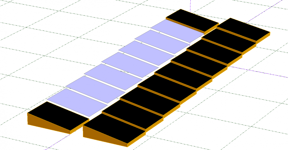

  8. Hello, I built this 3d shading scene: The problem is that when I move to the module layout definition, I just get one only rectangular field corresponding (as size) to one of the rectangles in the shading scene, therefore i am not able to properly define the string composition. I never had any problem with the module layout section and this could be due to a mistake of mine. I already tried: deleting the definition of the module layout and reloading it, making all the rectangles in the shading scene as new objects instead of copy-pasting a single rectangle, removing the partition in the shading scene, reloading the whole project and reloading the whole program. Nothing of this worked so I don't really know what to touch anymore. If needed I could send you the project files by e-mail. Thanks in advance for any help. Best regards, Michele
