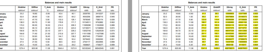

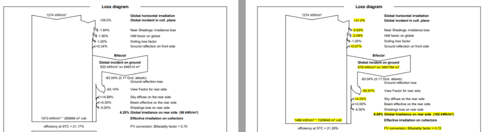

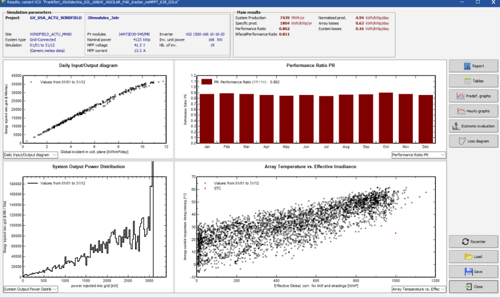

  6. Dears, I have recently upgraded my PVSYST to 7.3 Recalculation of the same project variant calculated before in 7.2.21 provided totally different yields. Need to add that former calculation is more trustworthy. Does anybody has similar bug expierience? Screeenshots depicting the difference are attached. Difference is huge. Please look at the system power distribution. 1804 - PVSYST 7.2 1478 - PVSYST 7.3 M

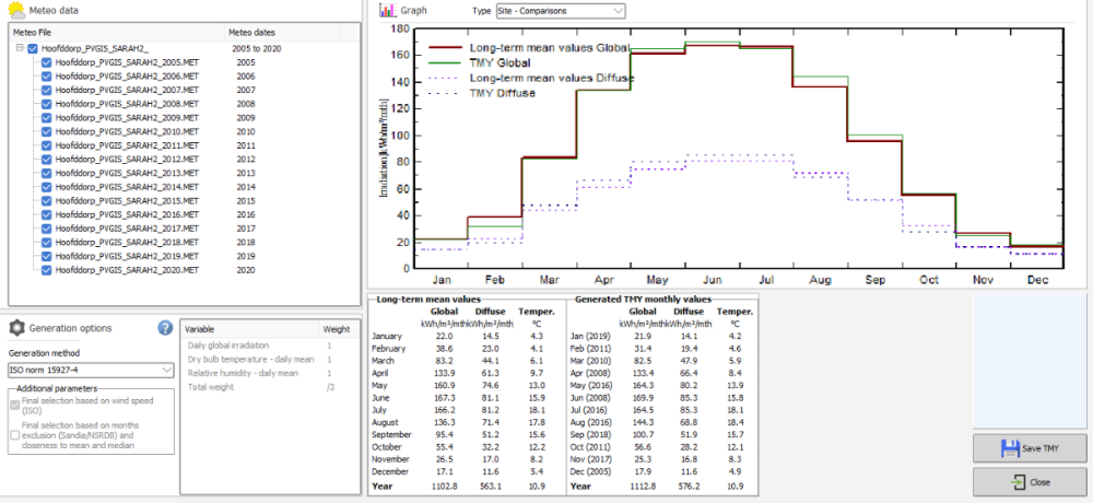

  7. Hi both, I noticed that there is a significant difference between TMY and related monthly GHI values when data is downloaded by PVSYST embedded function: VALUES: And natively downloaded data from PVGIS site: Could you elaborate on this. Many thanks in advance. Regards-Maciej
