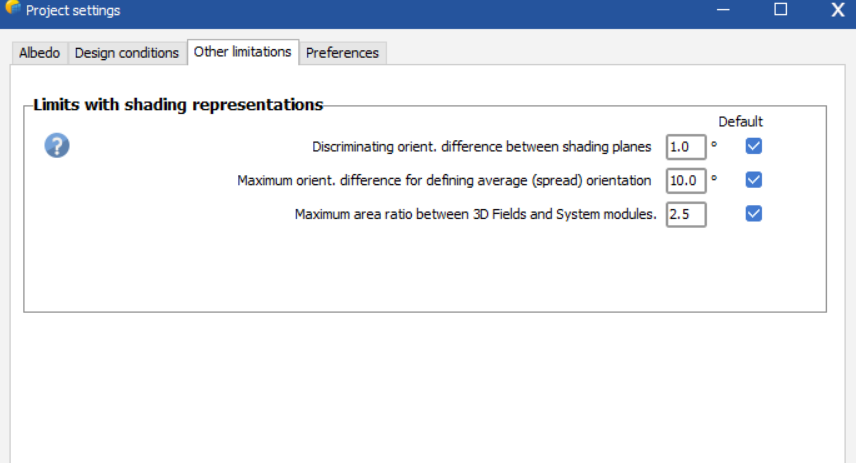

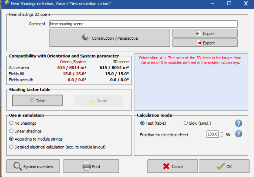

I have defined the exact scene and system but it still gives orientation is far larger error. Kindly tell me about this error.
Hi PVSyst Support Team, I have the same problem and the bug persists despite trying to save the variant and reopen it. have you found another way to solve the problem please ?
