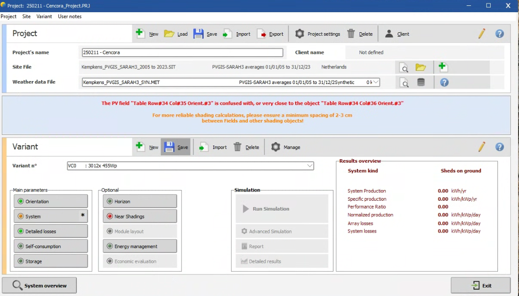

S Groenveld replied to S Groenveld's topic in Shadings and tracking
When I put my system layout in, it is giving me this error. I checked my project and there is nothing wrong with this. Also I only have 2 orientations but PVsyst made it 3. -
S Groenveld started following Shading scene construction error/bug
Hello, When I try to import my 3d scene from VirtoCad as usual, since the new update there is a problem. When I import the scene as usual, I can't 'find' my scene, while it does see the amount of panels it gave a bug with the orientations. Before the update I could just work like this and now I can't use pvsyst. It happens with every project. Can you please help me with this? Thank you in advance.
