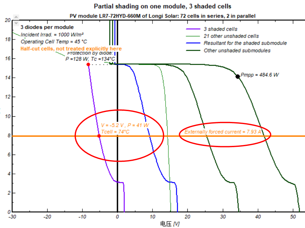

  2. as we can see the three values on the figure, the V (-5.2V),I(7.93A) and P(128W),Is there a formula that can explain their relationship,thanks!
  3. Dear pvsyst team: I am using this software to simulate the temperature and power when a cell is local shading. I find that “externally forced current= 4.4A” is all the same for the different solar modules. What does it mean? thanks!

  23. sorry ,i find a mistake in my sentence,the solar size is 210mm*105mm,so final result is 44/ ( 0.21*0.105*29) =25 = 94 (℃).The results are basically the same as those of pvsyst.
  24. just choose "Generic_Mono_700W_Half_Bifacial.PAN" for example. Here, Uc = 29 W/m²·k, or say Uc = 29 W/m²·℃, and the size of the cell is 150 mm*210 mm. For one solar cell shading, if the temperature rises by 1 ℃, it need power 0.21*0.15*29= 0.9135(W),and the cell power consumption now is 45W,45/0.9135= 48.17 (℃),by adding 25 ° ambient,the result is 73.16(℃),which is not quite consistent with the results shown on the graph (95℃).Can you help me check if there are any errors in my deduction? thanks
