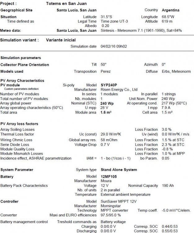

pgambetta Posted February 4, 2016 Posted February 4, 2016 Dear AndréI'm designing a stand alone PV system with batteries. I simulated the system and obtained extranges results (or at least I can't understand them) as PR>1 or missing energy equal 0 when the PV system produce less energy than load requirement. (see attachment)Could you help me to know what is wrong? Thank you very much
André Mermoud Posted February 10, 2016 Posted February 10, 2016 The behavior of this system seems indeed strange. But the information about the system is not complete. Please send your whole project (using "Files => Export projects") to support@pvsyst.com.
