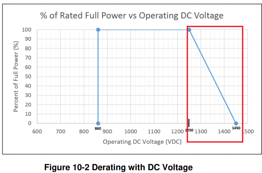

kjs55 Posted June 1, 2023 Posted June 1, 2023 (edited) Hi, I'd like to follow up on this post as it's becoming more common to have inverters which derate power output as a function of dc input voltage. I don't understand the above response by PVsyst as to why this cannot be directly implemented in PVsyst (e.g., via additional inverter characteristic definition settings in the .OND file) in a straightforward manner. Please clarify it. Thanks. Edited June 1, 2023 by kjs55 Slight editorial
jonipa Posted June 29, 2023 Posted June 29, 2023 I would also like to follow up this topic. It is still not implemented in PVSyst and can lead to errors on yield results, specially in high oversized DC generators.
