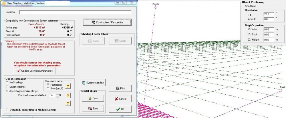

j.meier Posted November 24, 2014 Posted November 24, 2014 Hi,I have some problems with the 3-D-shading scene. It doesn't update the changes I have made in the construction tool.I chose the tilt of 20° but it shows me only 0° (see screenshot attached)May this have anything to do with the Sub-arrays I have defined in the system definition?Thanks for your help.
André Mermoud Posted November 24, 2014 Posted November 24, 2014 Which version of PVsyst are you using ?I think I had corrected such a bug some months ago.
André Mermoud Posted November 25, 2014 Posted November 25, 2014 Therefore this is a bug, that I don't know (and I cannot reproduce). Please send me your whole project, using "Files" / "Export project" in the main menu. Send it to support@pvsyst.com.
