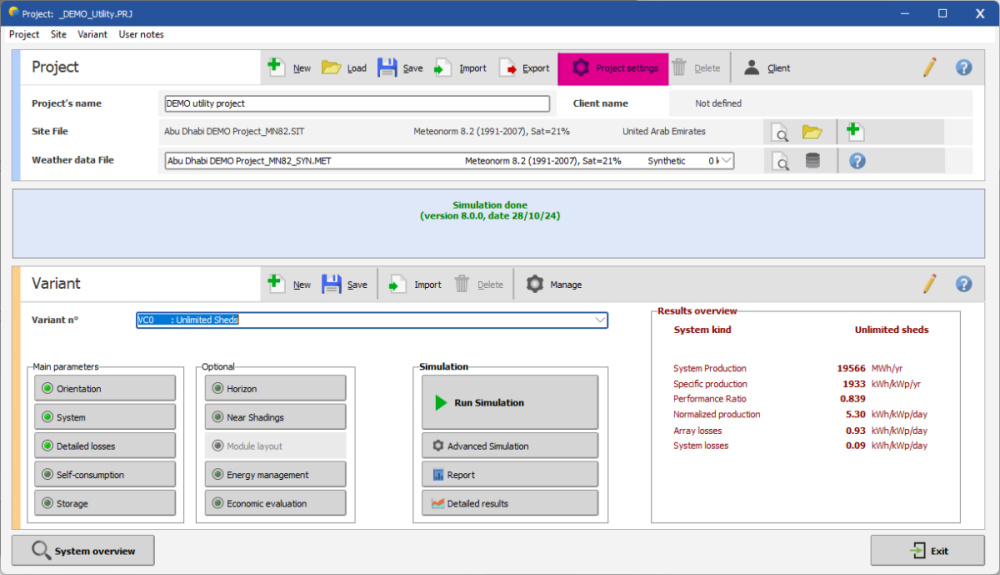

Muhammed Sarikaya Posted November 29, 2024 Posted November 29, 2024 Dear, Please click on "Project Settings." Then click on "Other Limitations." After that, you can adjust this limit to avoid the issue. Regards,
