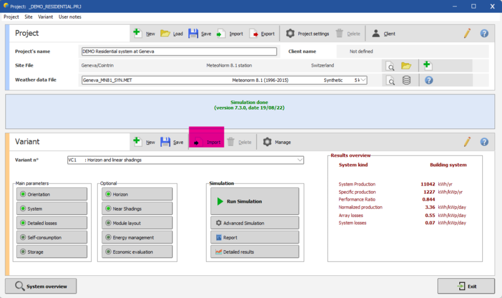

Hampus Olofsson Posted September 3, 2024 Author Posted September 3, 2024 Okay. Is there any other convenient way to simplify the process a bit? Can I create and save a "standard project" with default values that I then import for each new project?
Muhammed Sarikaya Posted September 4, 2024 Posted September 4, 2024 Dear Hampus, You can create a basic variant, and then for each new project, you can import this variant by clicking on 'Import,' as shown below: Regards,
