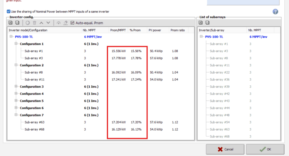

I am writing to inquire about the Multi-MPPT feature in PVsyst and its practical implications for string inverters.
I understand that this feature allows for the simulation of different power setpoints for each MPPT input based on sub-array power. However, in practice, most string inverters do not have the capability to independently adjust power setpoints for individual MPPTs.
Given this discrepancy, I would like to understand how the simulation results obtained through the Multi-MPPT feature in PVsyst translate to real-world scenarios with string inverters.

The "Powr setpoints" that you mention here is indeed the limit nominal power for this MPPT input. This is not fixed in the inverter. This is the result of the "Power sharing" calculation by PVsyst, for ensuring that the PNom of the whole inverter is the sum pf the PNom of each MPPT input  (according to their own number of PV modules).
Answers to your questions:
1.  During the simulation, each MPPT input is supposed to have a PNom corresponding to the value listed here. In the real system the limitation will be the Pnom for the whole inverter.
