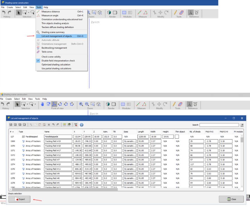

MGLopez Posted August 4, 2023 Posted August 4, 2023 Hello, On uneven ground, with automatic slope of modules tables, the distribution of the different orientations among the different tables is not easy to visualize. This is important to assign the tables to the mppt of the inverter and to detect if the table distribution on the ground leads to a realistic system or not. Today, I mark a vertical view of the whole tables set, with the number of each table, open the dialog for each table, one by one and record manually the different characteristics of each table : so lengthy ! Could it be possible to get automatically such report ?
dtarin Posted August 4, 2023 Posted August 4, 2023 Yes, in the shade scene, you can pull up all objects and export all data. It is under tools menu.
MGLopez Posted August 7, 2023 Author Posted August 7, 2023 Thank you for the tip that allow to export a .SHD file describing in PVSYST language the shade scene. I had dreamed about a table. I will make it for the .SHD file. Thank you.
