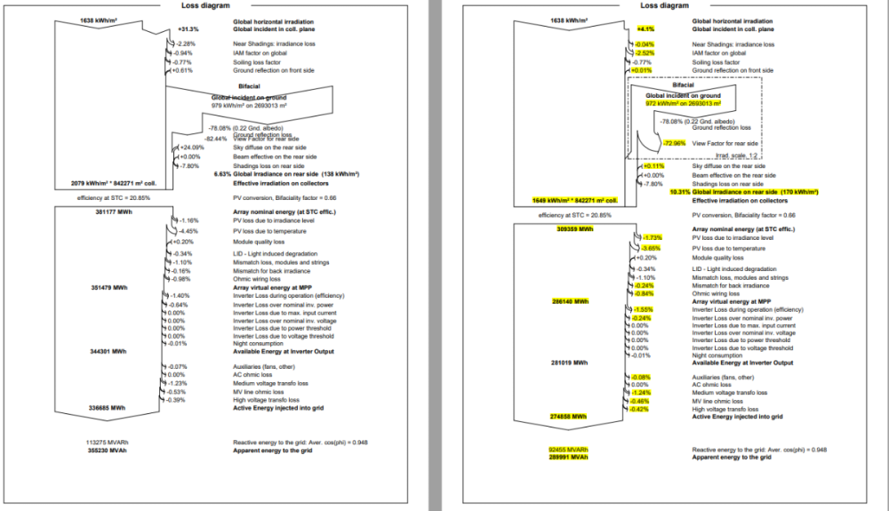

Simone Marletti Posted January 7, 2023 Posted January 7, 2023 Hello, I was running a simulation with Irradiance Optimization with new and I noticed very strange results in the new Version 7.3.1. Not sure if you have noticed the same issue here? Thanks, Simone
