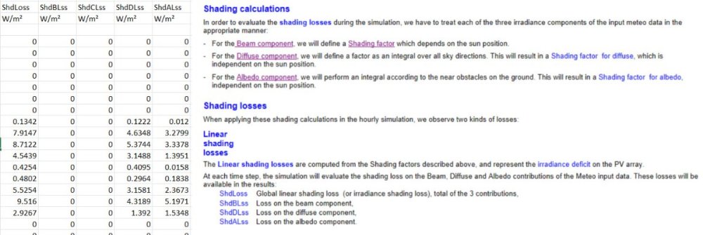

dtarin Posted October 13, 2022 Posted October 13, 2022 Near shadings consists of beam, diffuse, circumsolar, and albedo losses. @PVsyst, circumsolar is missing from the help menu, see attached.
