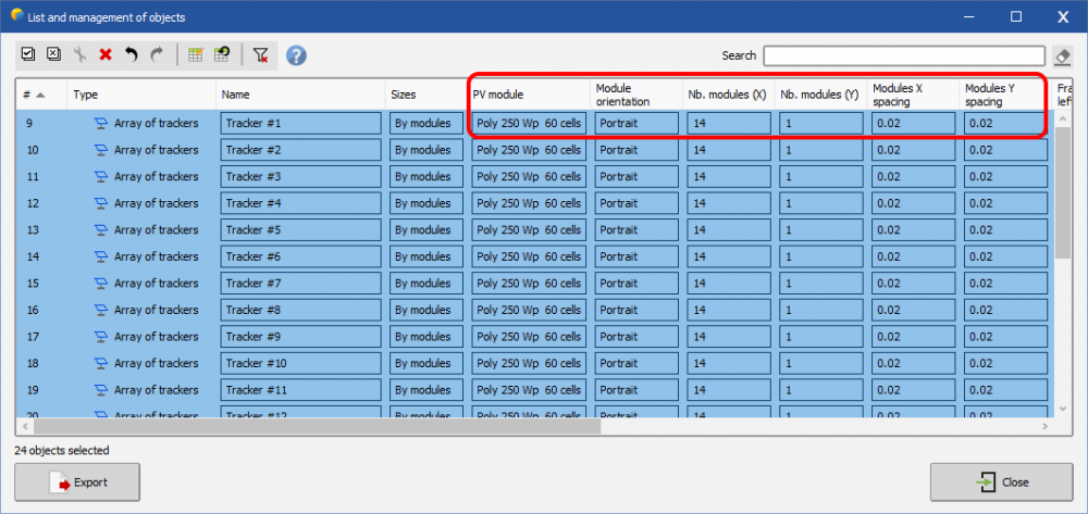

Stéphane Metz Posted February 7, 2022 Posted February 7, 2022 HelloA quick way to change the sizing type is to use the “List and management of objects” dialog in the near shading scene (CTRL + G ):
Andreos Posted February 22, 2022 Author Posted February 22, 2022 This solution does not seem to work with trackers, haven´t tried with tables. First, I can choose and highlight all trackers as your picture, but when I select the drawdown menu to select "By modules" it only changes that particulary one of the drawdown menu selected, not all at once.Second, if I change to "By modules", that tracker will change its orientation, dimensions, etc. And if I try do correct things in the menus it becomes a mess from where I cannot comeback.So, does this work with trackers, and how?Thank you!
Stéphane Metz Posted February 24, 2022 Posted February 24, 2022 Hi Andreos,So, does this work with trackers, and how?Grouped modification also works with trackers in the same way that single tables (select all then click on one 'By sensitive' cell, be sure that you keep all selected):Second, if I change to "By modules", that tracker will change its orientation, dimensions, etc.If the initial size of your trackers does not match the defined module type and number, it is completely normal for the size of your trackers to change. In the same way, you can modify the 'PV module', 'Module orientation', 'Nb. modules' in X and Y and 'Modules X and Y spacing' parameters:And if I try do correct things in the menus it becomes a mess from where I cannot comeback.You can go back in case of error by doing undo/redo (CTRL+Z/CTRL+Y).You can help yourself with the tutorial available on our Youtube channel:
