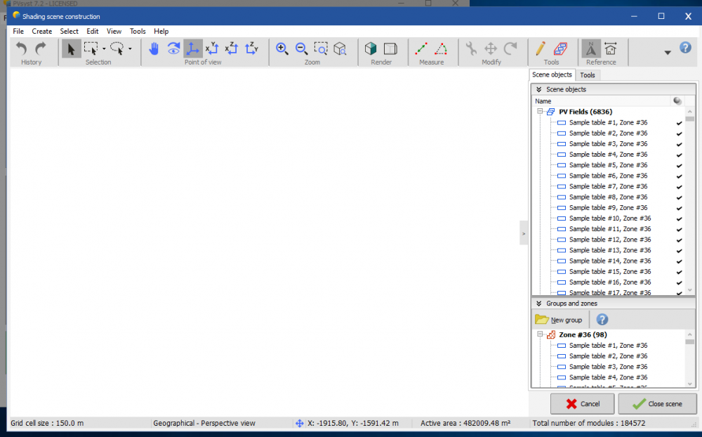

AronC99 Posted January 3, 2022 Posted January 3, 2022 in Shading Scene, all objects are missing, even when creating new one :cry: . Please assist on how to show missing objects.Thank you!
dtarin Posted January 19, 2022 Posted January 19, 2022 Getting this in 7.2.11. Cannot save as new variant to resolve, or create a new shade scene; problem still persists.
Stéphane Metz Posted February 7, 2022 Posted February 7, 2022 Hi all,This problem was not reported to us through the support channel.We haven't made any noticeable changes in the 3D display in latest versions.In most of the cases, this kind of issue occurs due to the machine’s graphic card configuration :The graphics card driver is out-of-date: Please check that your display drivers are up-to-date (https://forum.pvsyst.com/viewtopic.php?f=17&t=2771).There are conflicting graphics cards in the machine: If you have a dedicated graphics card, please follow the procedure linked below: https://nvidia.custhelp.com/app/answers/detail/a_id/5035/~/run-with-graphics-processor-missing-from-context-menu%3A-change-in-process-of. If the problem persists, do not hesitate to contact us by email: support@pvsyst.com
