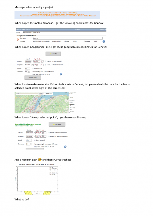

I have just updated to 7.2.9 and when opening old or making new projects, the site database seems to be corrupted. :?
Has anyone seen this behavior and if yes, do you have a workaround?
File showing weird site database behavior
Problem solved by support fra PVsyst support, who gave me this hint:
I have found the error that causes all your problems: the thousand separator character is automatically removed from all texts when converting them to a decimal values.
This happens if your internationalization settings for the thousand separator are on “Windows settings” (as seen below) and your windows locale language is Danish, that defines the comma as decimal separator and the point as the thousand separator.
The error leads to PVsyst removing all points from texts from the databases… and it’s quite normal that it behaves incorrectly or crashes afterwards!
