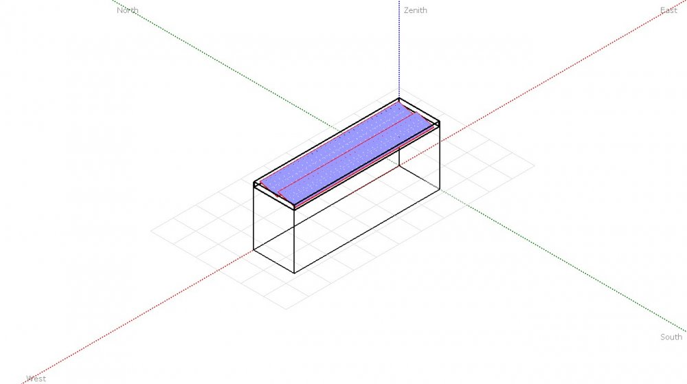

sehensie Posted December 14, 2021 Posted December 14, 2021 How to solve the problem "the modules area defined in the 3D scene is lower than the modules area defined in the system"I use array of tables, there is no more room for addictional array.the layout of PV arraythe error
dtarin Posted December 14, 2021 Posted December 14, 2021 Set that in hidden parameters, see screenshot below.
sehensie Posted December 15, 2021 Author Posted December 15, 2021 Set that in hidden parameters, see screenshot below. I got it. Thanks a lot.
