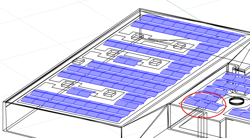

I'm seeking the best way to simulate an East/West configuration in the "Near shadings" tool. There is no possibility to create directly East/West modules with the "Zone editing" tool.
In the attachment, I succeed to create PV modules with opposite azimuths by using the "Zone editing" tool twice. But the problem is many modules aren't flat.
Do you have any idea or suggestion to create East/West modules with the "Zone editing" tool?
Thank you for your support!
East/West configuration test
Is the surface you are placing them on flat? Is there sufficient spacing between modules so they dont overlap? you can place them on a flat surface, then move them over and onto the roof.
