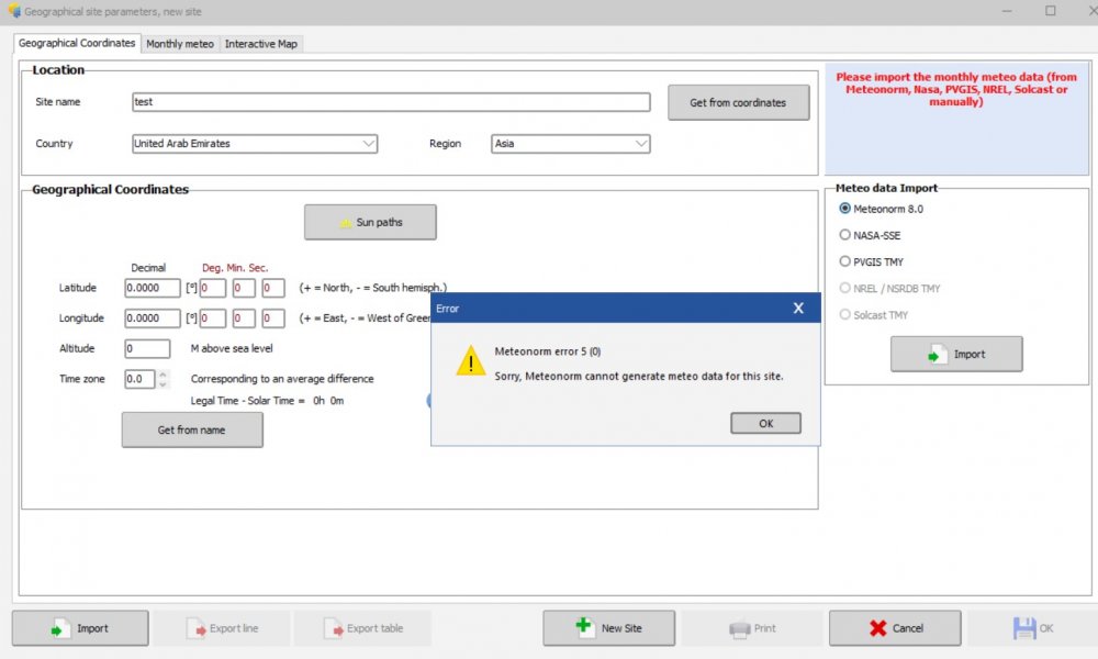

I am receiving the same error as the above user did, the only difference is that, for me its showing error 5. As per your reply I checked my windows version and the .NET framework version and everything is to date and still i am facing the same issue. It was working fine till 2 days ago and then all of a sudden it stopped importing files from METEONORN.
Please find the snipped images in the attachment.
I would want you help on resolving this issue.

For future users who encounter this problem:
The error 5 is due to restricted internet access (firewall and/or proxy) in an unwanted interaction with the included Meteonorm database. It has been fixed in version 7.2.9.
For other internet access problems, remember to configure your firewall and/or proxy properly with the information available in our FAQ: “Web services for all PVsyst functionalities” -
https://forum.pvsyst.com/topic/2524-web-services-for-all-pvsyst-functionalities/?do=findComment&comment=6420
