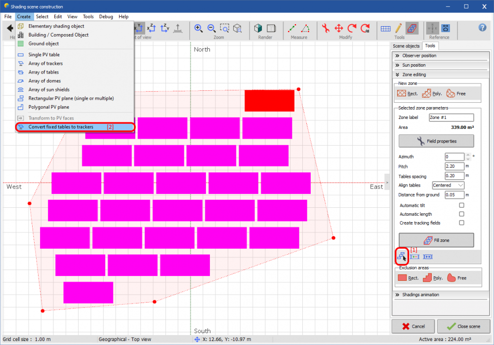

Hi, is it possible in the Near Shadings tool, to Fill a Zone with a tracker horizontal axis N-S selected in the Orientation tool? When I do this I get a lot of trackers one above others, with no pitch or tables spacing, as the image attached. And if I tick the create tracking fields box the azimuth is no longer 0º in the trackers perspective, i.e. N-S orientation, but E-W instead. What am I doing wrong?
Dear Andreas,
When you fill a zone, you fill it with single PV tables. Once finished, select all the zone tables [1], and click on "convert fixed tables to trackers" [2] (You can also change the azimuth to orient your trackers the way you want):
