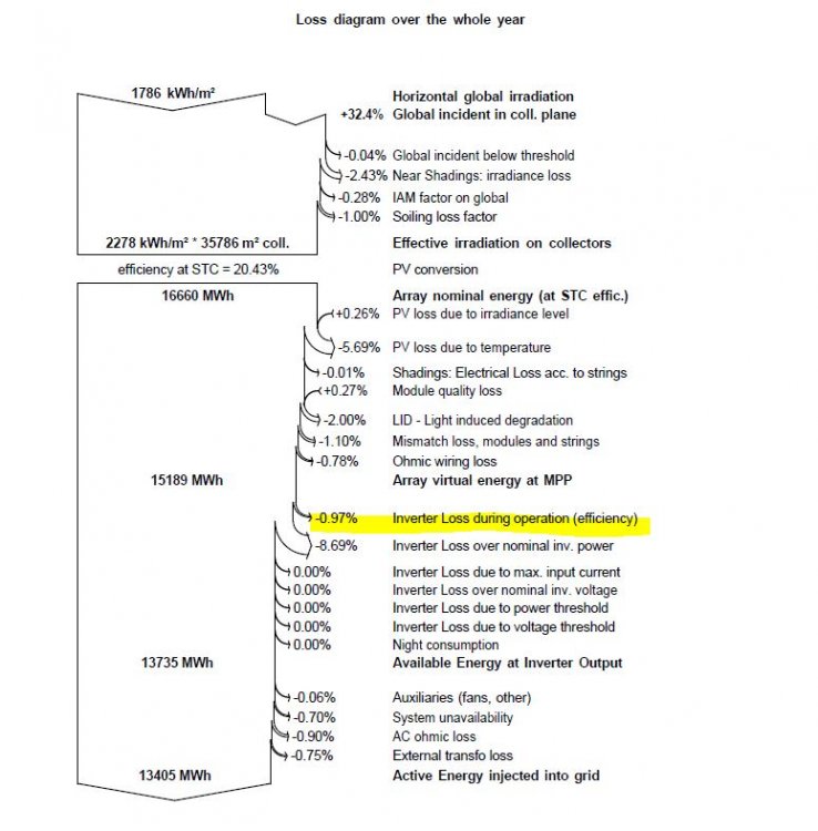

johnmin87 Posted April 8, 2020 Posted April 8, 2020 Hi All,My inverter efficiency loss according to the loss diagram over the whole year is .97% which seems low based on the efficiency curve shown on the OND file.I also plotted efficiency over the whole year of simulation, and the average efficiency was around 98.41%.Is there any good reason why the efficiency loss in the report is lower than expected?
André Mermoud Posted May 24, 2020 Posted May 24, 2020 I don't know. When you calculate the average efficiency (from the hourly CSV file?), don't forget to weight each houtly point by the EOutInv value.
