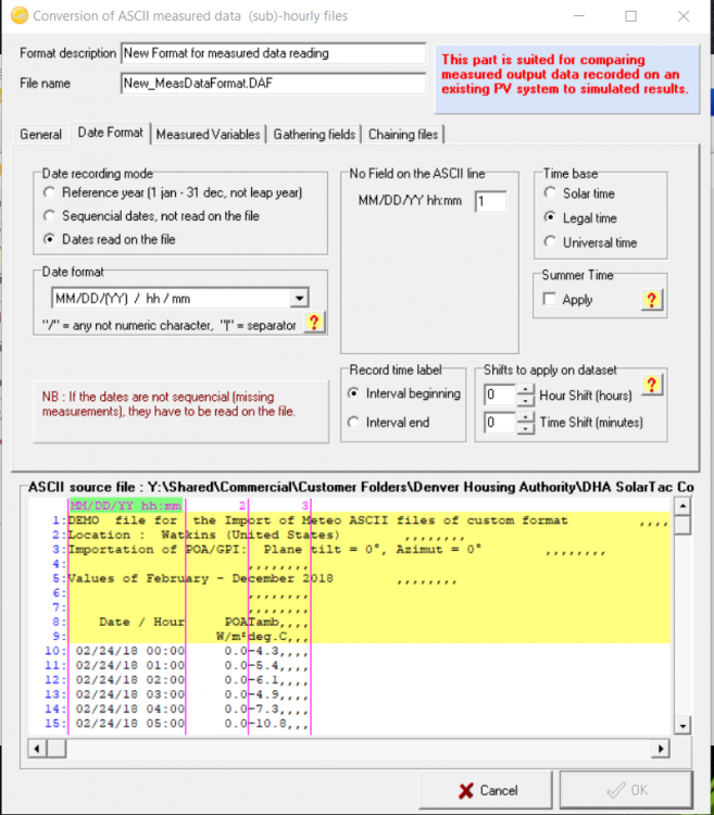

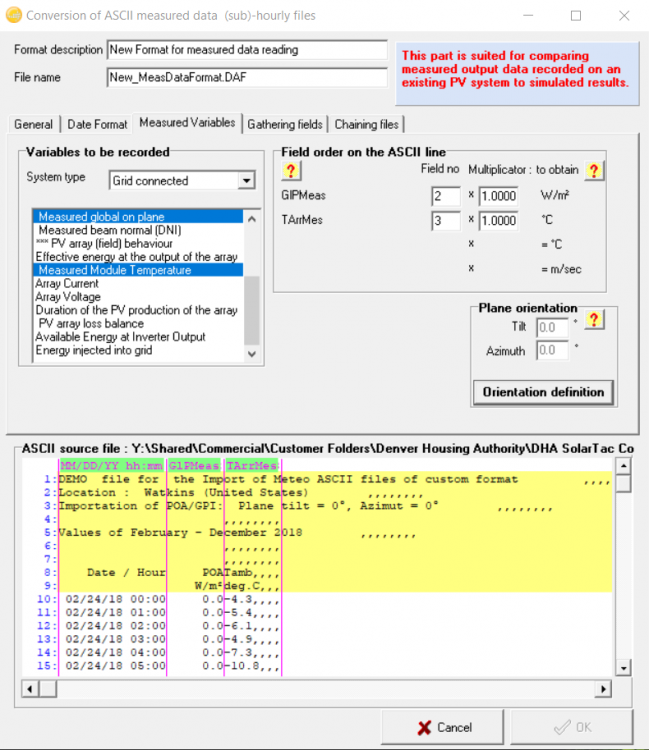

I am having trouble uploading an ASCII file that contains measured Plane of Array (global on plane) and Module Temperature. In the 'Conversion of ASCII measured data' area, I can populate the tabs for General, Date Format and Measured Variables in a way that looks like it should work, but the OK button does not become available to allow the conversion to advance.
The project in question is a single-axis tracker.
Attached are screen shots from the the uploading process.
Also attached is the data set I'm trying to upload.
I wonder if you can help me understand whether there is a formatting or other issue that needs to be addressed to move the process forward?
