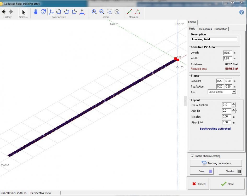

I have been playing with Pitch E-W to find the best column spacing for a single axis tracker but it seems like only comes up with 0% near shading losses from Pitch E-W 3 meters to 6.5 meters where it jumps to 0.1% near shading losses
I dont think its right, attach is what i have in the construction/ perspective window and when i run the shading table the albeo and difufse losses are 0 no matter what
help?
Your shading scene looks okay, can you share the report for 4m pitch?
You should have anywhere from 1.5% to 3% near shading loss (irradiance) depending on your location.
