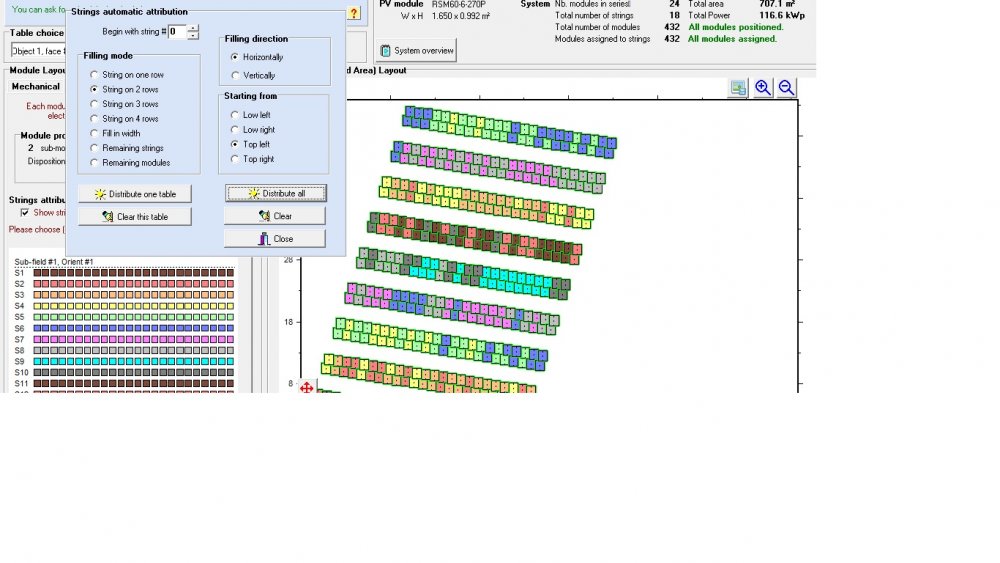

There is still a bug when we import shading scenes (eg from Google Sketchup) and later on we set them in Module Layout in order to simulate with accuracy electrical shadow losses. The thing is that we have to fill the strings manually as when we select automatically it makes it randomly regardless of the choice we select.
I'm attaching an example on a screenshot.
