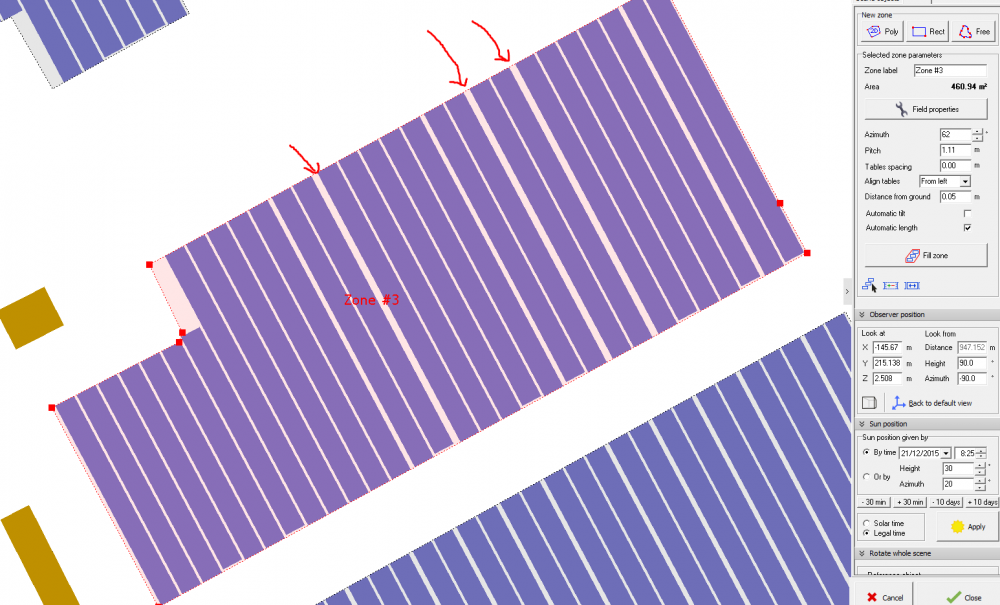

I am using version 6.6.3 and I have noticed that when I set a pitch and fill a zone, not all rows are set with the pitch assigned. Please see attached image. Can you provide any assistance or insight into what is occurring?

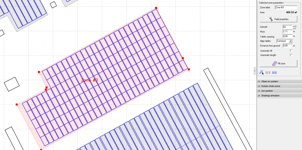

Edit: It seems this occurs when automatic length is used. We can see in the 'zone filling' picture with automatic length selected that the rows still do not end up equal length. The second image 'zone filling 2' has this option unchecked, and the zone fill is as it should be, with rows equal length and all with the appropriate spacing.
Could you please export the shading scene (.SHD) and send it to us at support@pvsyst.com ?
I just tried to fill some polygonal zones with automatic length and didn't get this kind of behaviour, so maybe there's something special in your scene.
