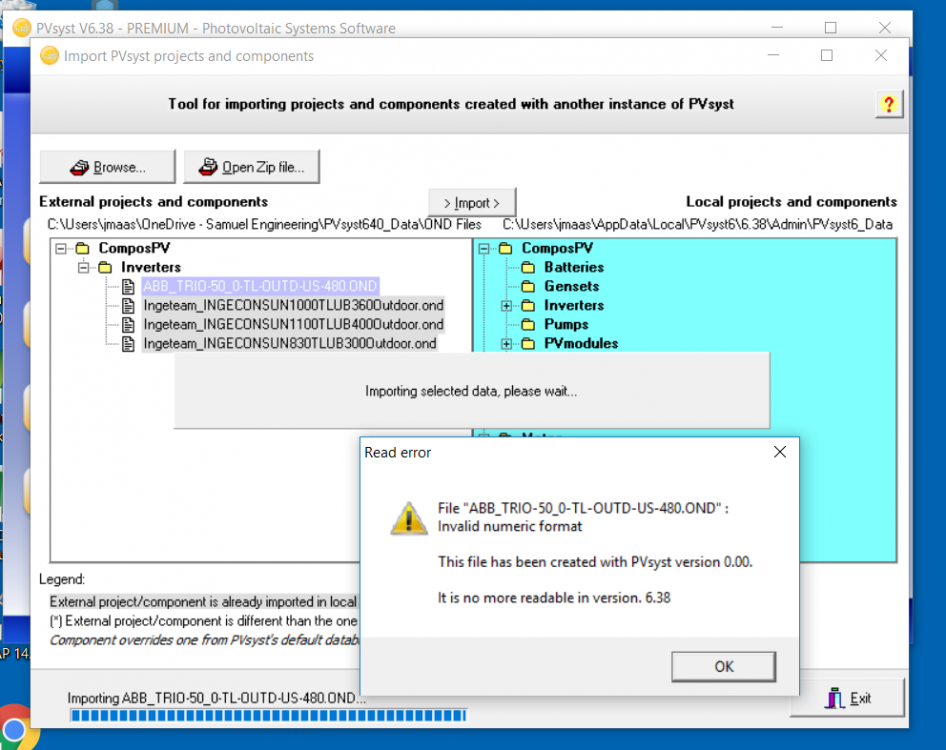

I have been having issues with .PAN and .OND files not importing into PVsyst V6.38. I keep receiving the following error message: "invalid numeric format - file has been created whit PVsyst version 0.00 it is no more readable in version 6.38"
Is there a way I can convert these files to be readable whit 6.38? These files were obtained from the manufactures and are their latest versions.
Thanks.
You can convert these files by opening them in a new version (> V6.40), and save them using the option "File compatible with old versions" in the saving dialog.
You can also ask the manufacturer for sending files in the old format.
