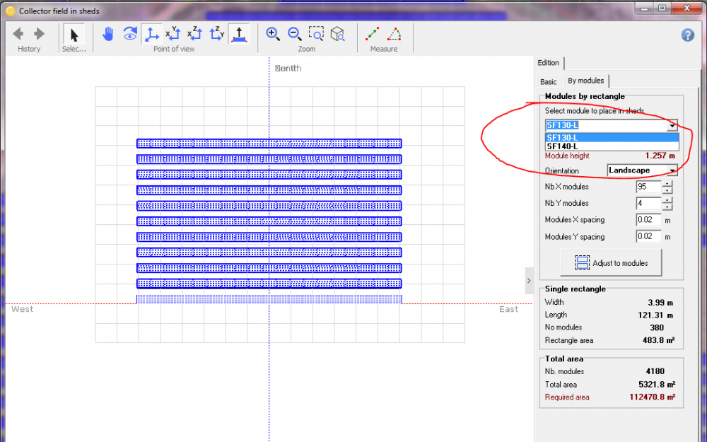

In the new shade scene construction, it gives an option to select the module for that shading object. I have a project with two different modules, and the shade scene seems to pick which module is attributed to which array by default, and does not change. If I select the module it is not defaulted to, it reverts back. Is this a bug, or is there something I am not doing or understanding correctly?

You're right the module is not correctly reselected in the list.
The other information is correctly kept though which should not cause issues.
Please keep in mind that this "By modules" tab is here to help you setup your fields with the correct width and height. It is a design-only tool, it can also speed up filling subfields in the module layout but the modules defined here in the shadings have no direct impact on calculations.
