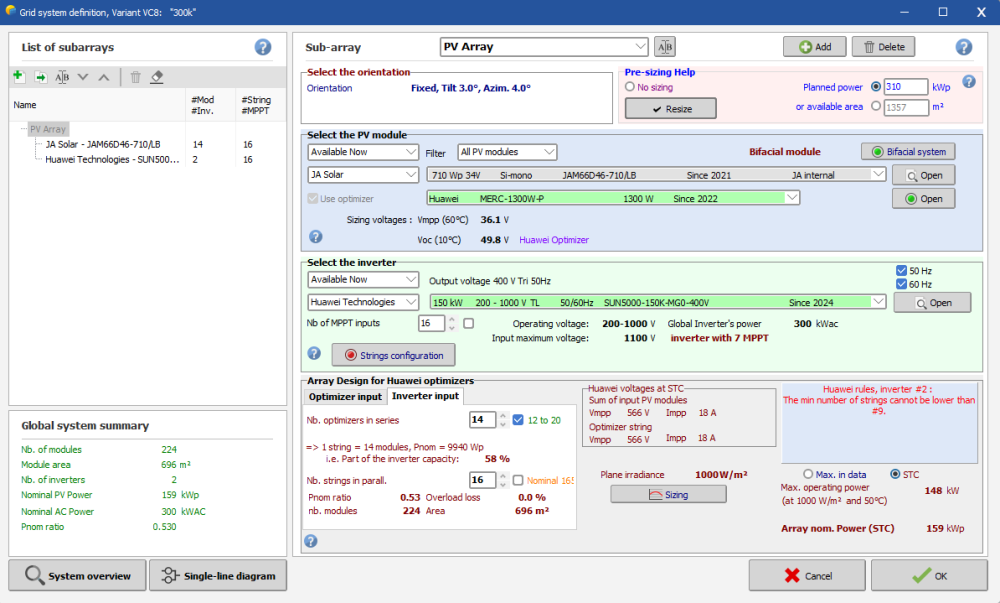

  1. I tried to arrange string with optimizer by Huawei SUN5000-150kTL-MG0 Datasheet and manual that said I can use 7 string and more ( From my understanding). But in the application show that I need to use minimum string is 9. How can I solve this problem ? or Is there another way to do it?
