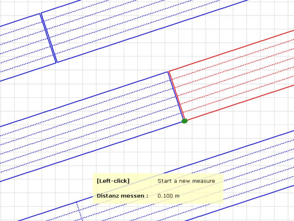

Hello, I have problems with the Import. I tried with a small plant and there have been no problems but with a larger plant, there are a lot... What I did: 1) Imported a DAE-3D-file from AutoCAD -> the tables are "objects" 2) Transformed to PV faces 3) Deleted the objects -> just PV-fields What happens: A lot of warnings like "the object "PV-field #46" is penetrating the PV-field "PV-field#45"." In fact, the distance between the tables is 10 cm (so >2-3 cm) If i delete this table, it happens somewhere else. Any hints?
