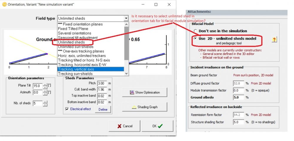

  2. Why the back side and front side output power of a Bifacial module are different while the front and back side both are illuminated with 1000W/m2 at STC condition ?
  3. Thanks Solar Guru for your reply. I have another query regarding the below mentioned points. Structure shading factor (default value is 5%) - 1) On what parameters basis the shading factor is taken as 5 % only ? Mismatch loss factor (default value is 10%) 1) What does mismatch at back side of modules means and why this value is taken 10 % as default ? Thanks
  4. Hi Andrew I am trying to simulate Bi-facial modues , but having few query regarding the same 1) Is it necessary to select the unlimited shed in the Field type in the orientation tab for simulation of Bi-facial modules ? 2) can we simulate the bi-facial module with fixed orientation or several orientation if we design 3D for the same ? Please refer the attached image for the same. Thanks Nitin Panwar
