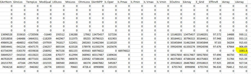

  3. While working on a project that utilizes SMA Sunny Central 2200 inverters I noticed that each time the input DC voltage exceeds 1000V the inverter outputs becomes zero. Would you be able to provide some insight on why is would be happening as I would think that if the input voltage exceeds the MPPT voltage range then the losses would increase but this should not shutdown the inverter completely. I have attached the screenshot of 8760 for reference. Also, I used the standard PVsyst OND file (for V6.52) to run this case. Thanks!
