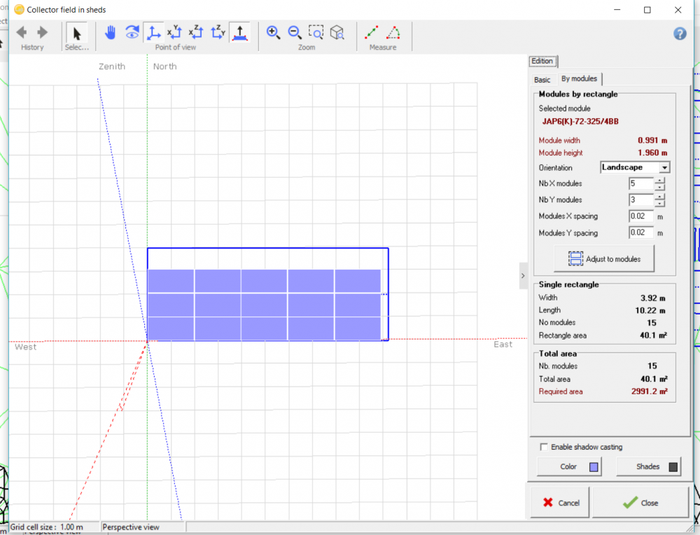

Hello, I have been having this trouble with PVsyst where when I open a .SHD file from another project or someone sends me a file, the near shading settings change, especially when defining the arrays. I am not sure why this does this. I have to sometimes readjust all the sheds.
