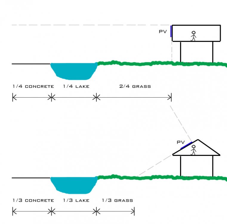

  9. But that was not the problem. I understand that lower tilt angles (that is: lower roof angles) lower the albedo effect on POA ground reflected radiation. The issue was to explain, what did you mean by "PV array seeing" in context of what area needs to be considered on reflecting the light onto the window, due to estimation of the average albedo. If I understood it correctly. this is what you meant (see attached photo for simplification). So in case of tilt angle = 90 (upper sketch): averageAlbedo = 1/4*0.25 + 1/4*0.75 + 2/4*0.20 = 0.40 While if tilt angle is 40 (bottom sketch): averageAlbedo = 1/3*0.25 + 1/3*0.75 + 1/3*0.20 = 0.35 I apologize in advance for the quality of the sketch. My intention is not to banalize the discussion, just to check whether or not I understood the explanations.
  10. Thank you André, But I am not sure I have understood you. You compared how lower tilt angles lower the albedo effect on POA ground reflected radiation. But how is that related with "looking through" the window comparison of how solar panel "sees" different areas (with different albedos) around it?

  12. Thank you Marvin, "PV array seeing" a particular area around it is basically like if instead of PV array on a roof, there would be a window on the same place. What a person could see through that window, would be "PV array seeing"? Did I get that right?
