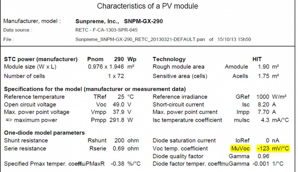

  12. Thank you for you response. The issue I am facing is that the PVsyst screen display and the pdf of the same PAN file are showing two different values of temperature coefficient of voltage. I will attach my screenshots here. Could you please tell me why this is happening?
  13. Hi I encountered this issue while examining a PAN file provided by a manufacturer. The PAN file was imported into PVsyst version 5.68. The PVsyst screen for PV module definition shows the value for muVoc as -153mV/C whereas the print out of the PAN file from PVsyst shows the value of muVoc as -123mV/C. An explanation for this discrepancy would be very helpful. Has anyone else encountered such a problem? Thanks, Aparna
